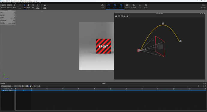

I’m facing a problem with camera animation.

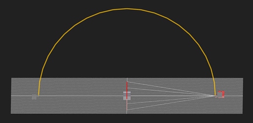

I would like to make a mouvement that goes over my object from front to back, with a 180° twist to keep back side well oriented.

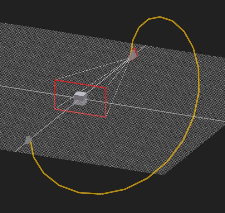

But if I make a inclination animation + twist animation, the camera path twist too. Inclination direction is modify by the twist.
Anyway to avoid this and keep camera just twisting on the inclination path?
Just inclination (path I would like to keep)

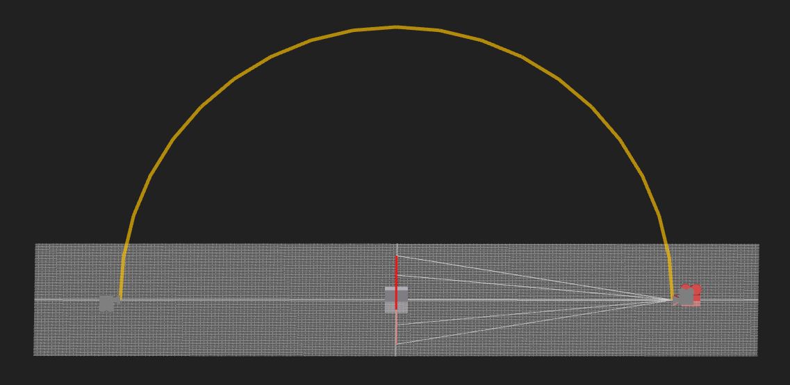

Inclination + Twist:
Thanks.
Mmmz I was trying and wonder what the answer is. It would have been much easier if the ‘translation’ not only could move the camera but also rotate it.
I tried to cut the inclination animation into two parts and put a fast twist between them since I think you basically want that just a quick transition.
What I didn’t try yet but might work is using two cameras. So you just do 90 degrees with one and the other 90 degrees with a camera which already has the right rotation.
I tried the second option, using two cameras. It kind of worked, but the twist in the middle became really rough and looked pretty wierd to me. It did give the desired behavior apart from that though, and perhaps there’s some way to fine tune it to look better. I work way too little with animations to know if that might be possible or not.

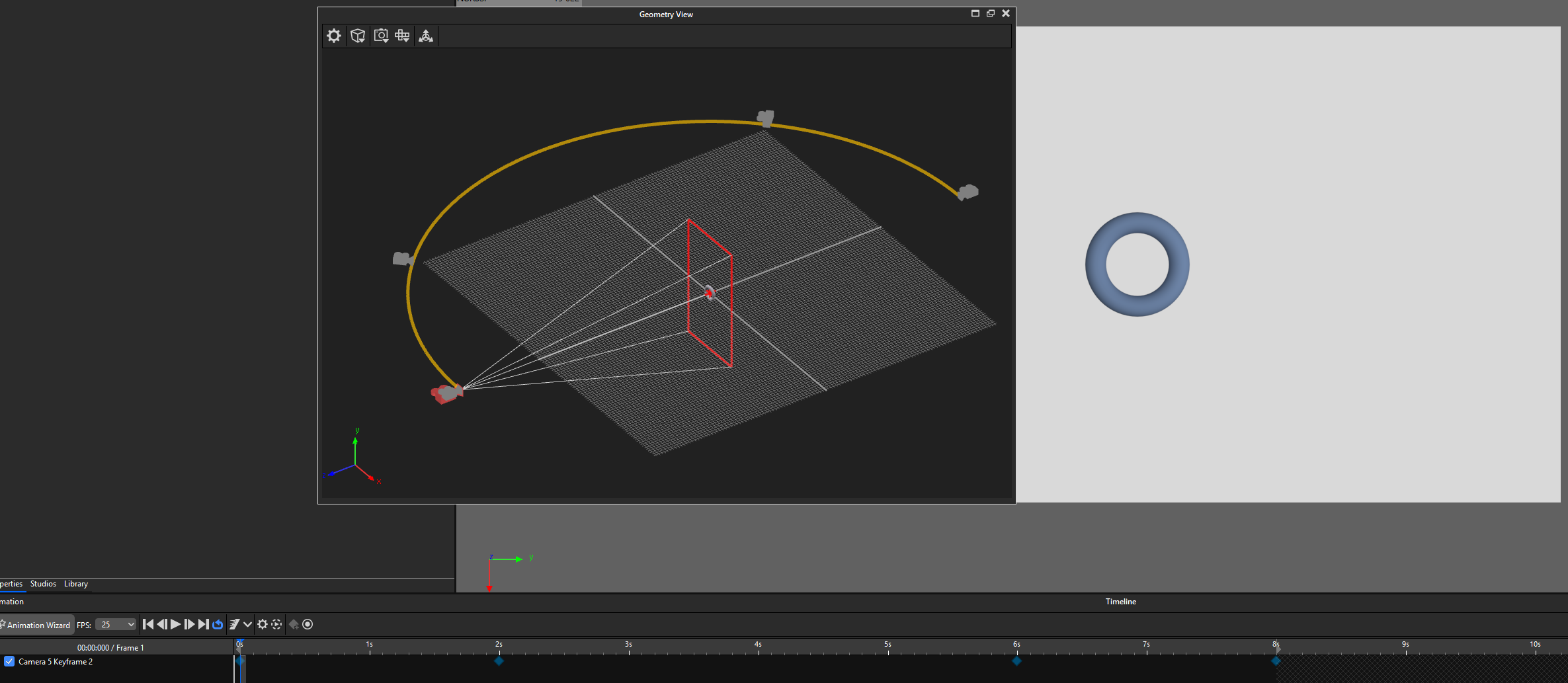

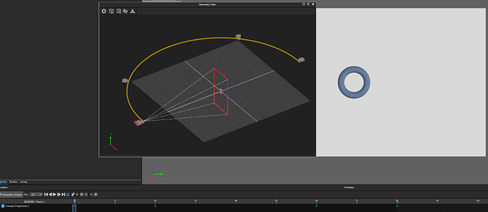

Faced the same problem, and solved it with Path animation. Isn’t a perfect solution, but the only way to quickly fix this translation, for now, I think.
Thanks for your replies.
I’ve tried too with camera keyframe, but as I want to stay perfectly aligned with middle plane, azimuth parameter switched from -90 to 90 instantly. I had to turn everything by 90° on X, now I’m not using the inclination but azimuth from -90 to 90 (or 0 to 180)
But it’s still not that good as I would like to stay not twisted at the begining and the end so there is no easing on the twist.
I’ve tried Orbit + Twist but same as Inclination + twist, path is deformed.

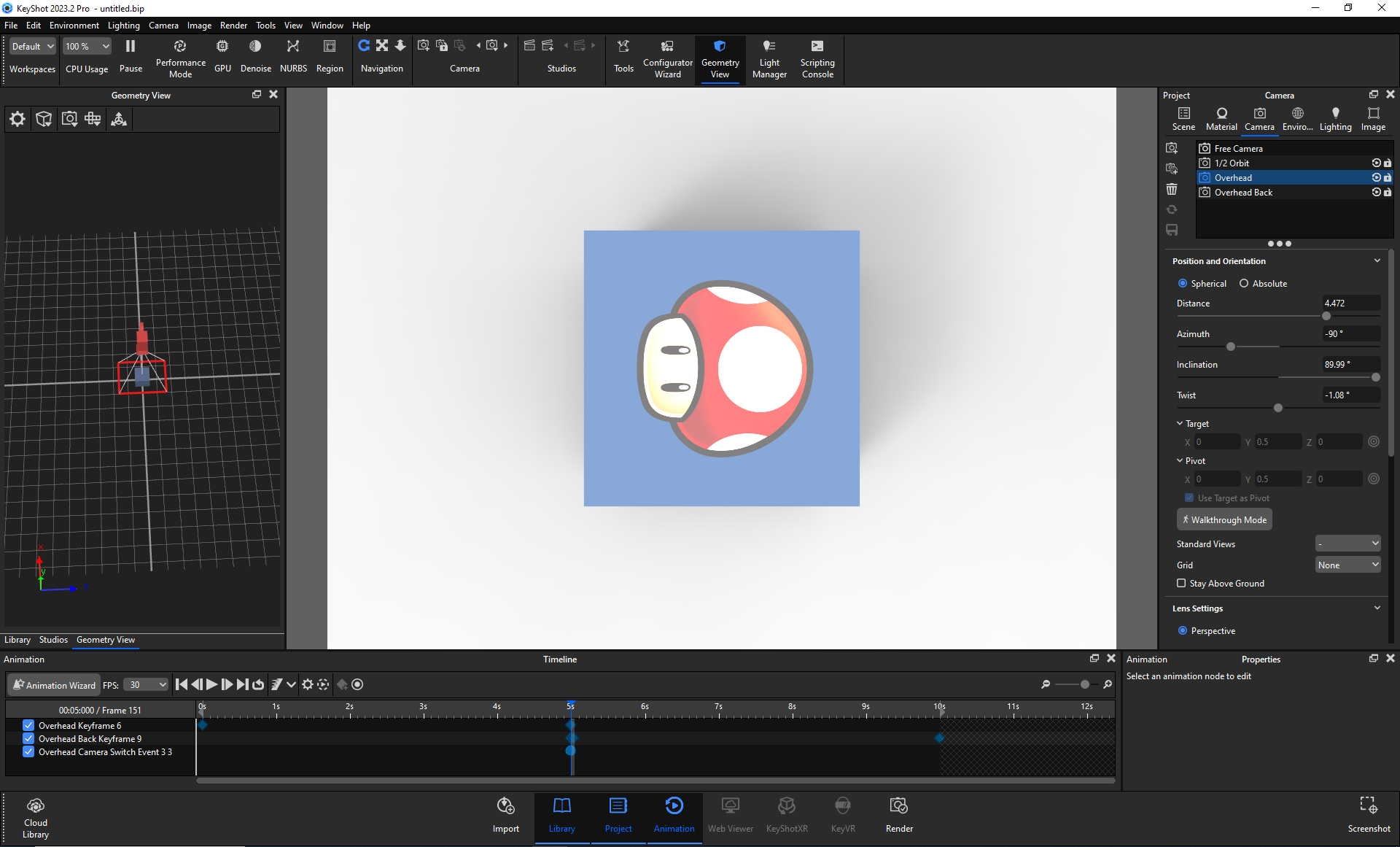

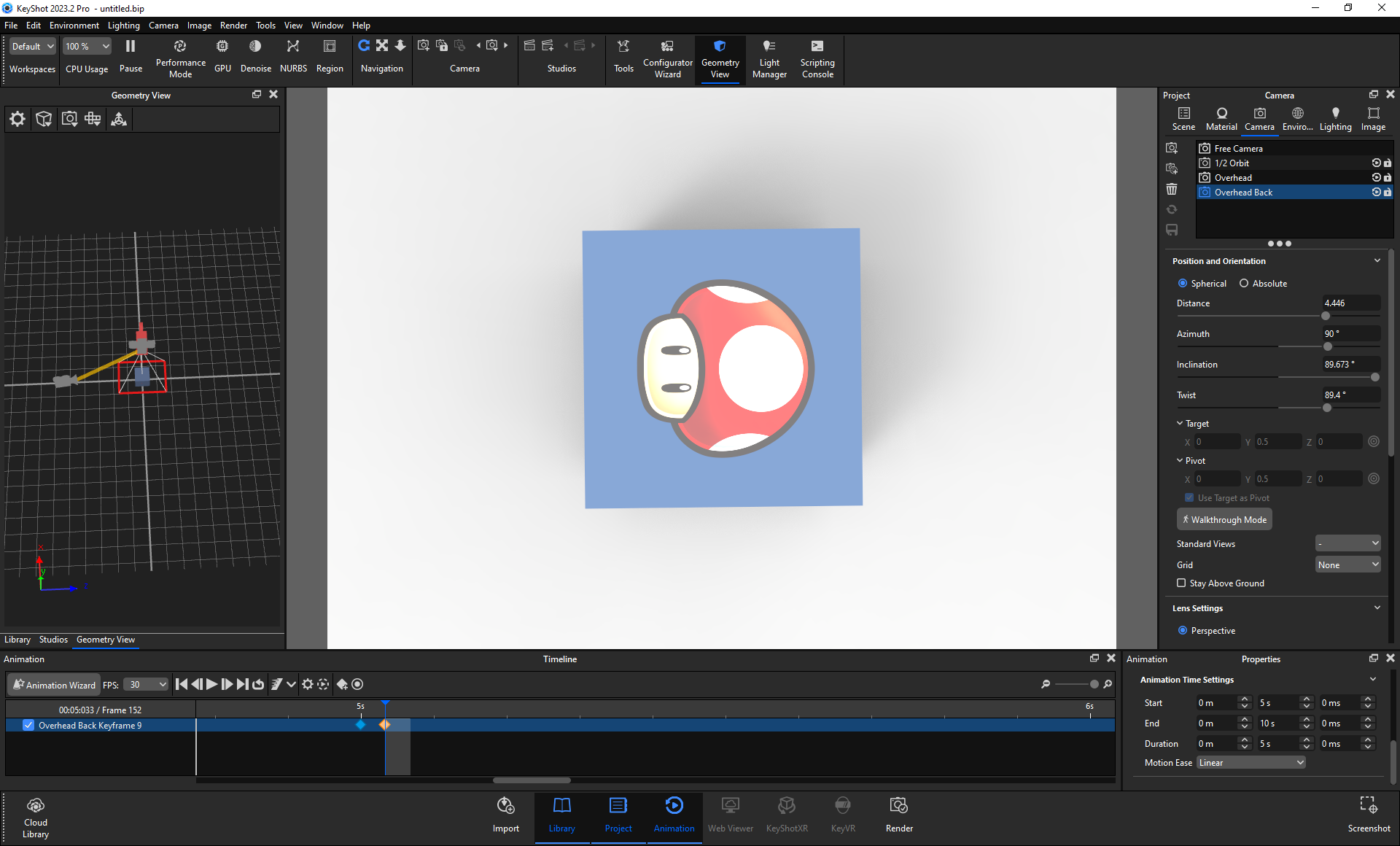

I am unsure if this is what you were trying to achieve, but I assume you are talking about the camera flipping over after reaching the median point when you are directly above the object.
The way I finagled it to work out is I created another camera animation for the back half, but for the frame right after the median point above, I changed the twist from -89.673 to +89.673. I merged the animations back together with a Switch Event Animation.
Since the flip seems to have to happen due to how the camera is program to work when going overhead the object, flipping the twist 180 degrees corrects it to match the Azimuth the camera wants. Because it is on the same frame that the flip happens, this switch in twist is not perceivable in the animation.
Hope I understood correctly what you were trying to achieve.
In hindsight, I believe the single keyframe animation version I included in the ZIP file I posted above is the most robust version for editing down the line.
When playing back the animation in real-time, it may look like the camera flips 180° at the median position, but that is only a visual artifact of real-time playback. If you skip through the frames manually, this does not occur. Neither when rendering the animation offline.
The only drawback is that a single duplicate frame is created at the median position (due to the double keyframes there), but this is unnoticeable at normal playback speed, especially at higher FPS.
In these “corner cases”, you would also want to avoid exact values like (-)90° for Inclination or Twist. The animation will be better behaved with an unrounded value like (-)89.99°. This is a side effect of how the animation system currently does interpolation between the camera parameter values.
